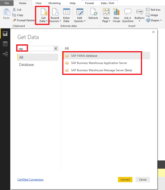

Hi @RahimZulfiqar,
I would suggest you try out the SAP connectors. If you have the permission to connect to the database directly, you also can give it a try.
How_to_connect_POWER_BI_with_SAP_Business_One_Software

Hello Dale @v-jiascu-msft,
You are not replying to the question to connect to SAP Busines One. Basically SAP Business One runs with a Microsoft SQL database.
Could you please advise?
Thank you and regards,
Fernando
Hi Fernando,
As we can see from the Power BI Desktop, there isn't a connector like "SAP business one". So my suggestion is connecting to the database directly. You also can try other connectors that the SAP Business One can provide. For example, sapbusinessone/odata/.
Please note: I'm not a professional of SAP. I can only provide some suggestions.
