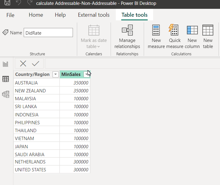

  • 1) You need to create a gradation table for the regions. you don't need to link it to other tables.
    gradation table
    https://1drv.ms/x/s!AiUZ0Ws7G26Rhkln5gYPr-gUB05T?e=Tv5iPw
    2) create separate key tables for regions and "category taxonomy" and link them to the fact table (main table)
    3) create the necessary events.
    1)
    Amount Sales =
    SUM ( 'Country Wise Spend'[Invoice Spend in NZD] )
    2)
    Addressable & Non-Addressable =
                MAX ( 'DidRate'[MinSales] ),
                TREATAS (
                    VALUES ( 'Dim Company Country'[Company Country] ),
                    DidRate[Country/Region]
    3)
    Calculate Addressable & Non-Addressable =
    IF (
        [Amount Sales]
            >= [Addressable & Non-Addressable],
        "YES",
        "NO"
    4)
    CF = IF([Calculate Addressable & Non-Addressable]="YES","Turquoise","Pink")
    Sample PBIX file attached
    https://1drv.ms/u/s!AiUZ0Ws7G26Rhkp4STeOWch-JhG3?e=Ikxn5a
