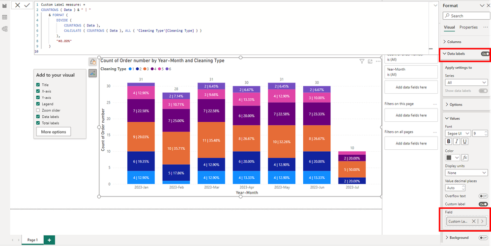

I am not sure how your datamodel looks like, but I tried to create a sample pbix file like below.
Please check the below picture and the attached pbix file.
I hope the below can provide some ideas on how to create a solution for your datamodel.
Custom Label measure: =
COUNTROWS ( Data ) & " | "
& FORMAT (
DIVIDE (
COUNTROWS ( Data ),
CALCULATE ( COUNTROWS ( Data ), ALL ( 'Cleaning Type'[Cleaning Type] ) )
"#0.00%"
If this post helps, then please consider accepting it as the solution to help other members find it faster, and give a big thumbs up.
