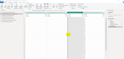

How to automatically remove Power BI rows if text length=1
Hello everyone,   I would like to entirely remove the rows if text length=1 for the Manufacturing Product Location Code. 1 column. For example, in below row 13 & row 14, the text lengh=1, would li...

    Hi marry
    You can add a length column:
    Filter out 1:
    and remove the unnecessary column
    Pbix is attached

    Hello Rita, Appreciated your help!!!!!I can successfully removed those rows. Thanks.
