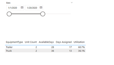

I therefore respectfully suggest this PBIX solution which you can download from Onedrive
Click hereHow it works ...
Use a detached Calendar table with contiguous dates for your slicer date window
Create a "slave" measure to calculate days avaialble
_Days available = // this measure must be used a XSUMX wrapper // get the unit add date var unitstart = SELECTEDVALUE(Units[AddDate]) // create a temp file of dates using the date slicer window and add date var mydays = FILTER('Calendar', 'Calendar'[Date] > unitstart ) RETURN // count the number of dates COUNTROWS(mydays)Then a "master" measure to iterarte the slave for each unit in your reporting context (eg contracts, units or equipment type)
Days available = // this measure uses the SUMX function to iterate the calcuation for any unit var daysavailabe = SUMX( Units, [_Days available] ) RETURN // avaiability can only be measured at unit or type level but not contract level IF(ISINSCOPE(Contracts[ContractID]), BLANK(), daysavailabe)Create a "slave" measure to calculate days on contract
_Days on contract = // this measure must be used a XSUMX wrapper // get the contract date range var contractstart = SELECTEDVALUE(Contracts[StartDate]) var contractend = SELECTEDVALUE(Contracts[EndDate]) // create a temp file of dates using the date slicer window and contract date var mydays = FILTER('Calendar', 'Calendar'[Date] >= contractstart && 'Calendar'[Date] <= contractend ) RETURN // count the number of dates COUNTROWS(mydays)Then a "master" measure to iterarte the slave for each unit in your reporting context.
Days on contract = // this measure uses the SUMX function to iterate the calcuation for any contract SUMX( Contracts, [_Days on contract] )When you run the the report at equipment type level then the totals roll up automatically
Page 1 shows the inner workings with the "slaves".
Page 2 shows the final reports with just the "masters" and without the "slaves"
Note all dates are in UK dd/mm/yyyy format but you can display them in USA mm/dd/yyyyyFor example there were 366 days in 2020 (leap year) but Unit 4 was added on 9Jan.
So it was available 366 - 9 = 357
It had a contract for 6 days.
Usage was 6 / 357 = 1.68%If you change the date slicer window to 12/01/2020 to 31/12/2020
then the availability and days in contract changes accordinglyThis method is easy to understand and learn, and easy to test because it does not have lots of switch branches.
If you just want to include working days and exclude weekends and holidays then you could add a working days column to the Calendar table, and aggregate that rather than count rows.Please click thumbs up for this suggestion (because I did spend a lot of time on it)
and also click [accept solution] if it works.
Hope it helps and makes up for our rocky start. 👍Warm regards, 😀
Warm regards, 😀
- B_Rax1 year ago
I've been busy on other things, but got some time to review this solution. I believe it will work for my report. Thank you for the assistance. The helper measures for SUMX was the step I had not considered.
