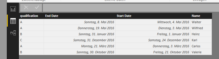

The following Problem keeps driving me nuts the whole last week:
I have an holiday table with a start and an end Date. There is a Coloumn with the qualification and a lot of other Coloumns with other details like the Name.
I would like to show a graph, which shows the sum of all people who are on holiday on the same day for every day in the year. So the X-Axis should display the year from January the first to 31. december. The Y-Axis should show me how many people are on holiday at the same time. I would like to be able to add a slicer to filter the qualification, name and so on.
To do this, i thought it should be possible to split up the Start and End Date to a table in which every row is displaying one day of the holiday.
But I don't know how. Please help me. Smiley Frustrated
