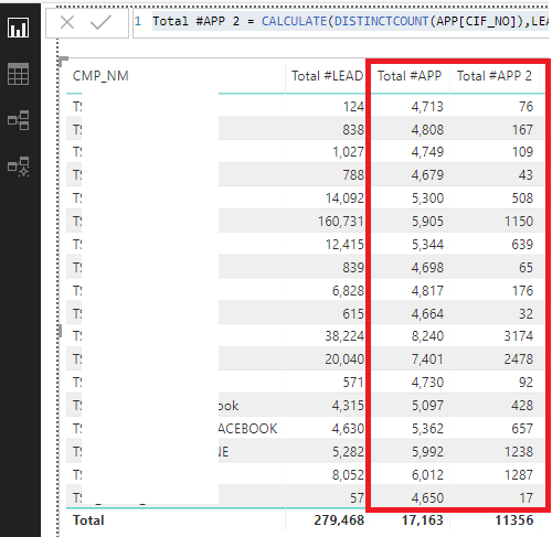

Hi @vpnnm,
I hope you didn't share anything confidential here.
Maybe you should count the [CIF_NO] instead. Please refer to the formula and snapshot below.
Total #APP 2 =
CALCULATE ( DISTINCTCOUNT ( APP[CIF_NO] ), LEADGEN[REALNM_NO] <> BLANK () )
