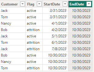

    Below is my table:
    It has employee columns, start date and end date and status columns for active or inactive.
    The following DAX might work for you:
    Measure =
      CALCULATE(COUNT('Table'[Customer]),FILTER('Table','Table'[Flag] = "active"))
    The final output is shown in the following figure:

    Below is my table:
    Measure =
