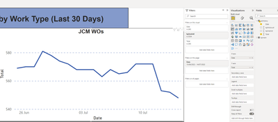

Having multiple lines on line graph using Maximo kpihistory table as the data source.
I am new to Power BI (just started yesteday) andd need some help on how to add multiple kpi histories to the same graph as the way I am currently doing it will only allow one.
I did look a one video but they seemd to have more options - I am using the free verison.
I am using the kpimainid, Date and Total columns from kpihistory table and need to be able to reference multiple kpimainids for my graphs.

I have also include how I have set up my line graph.

Hi @stefgiorgi
If you expecting mulitiple lines for example for each "kpimainid" you need a line then drag and drop the kpimainid column into legend section of the visual.

Thankyou @Hariharan_R that has worked.
I have one other question as the kpimainid is just a number i.e. it doesnt have the description of what it represents, can this be renamed?
Hi @stefgiorgi
Yes. You can create one more column with whatever name you want to give for each ID and use that column in the legend. You also can define the ID and name in excel and get the excel inside the POwer BI desktop and join with ID column and use that name column.

@Hariharan_R
IAfter what you said I realise I already had the kpimain table as a direct connection so have made the join with that. All now working as I need.
Once again thatks for all your help.
