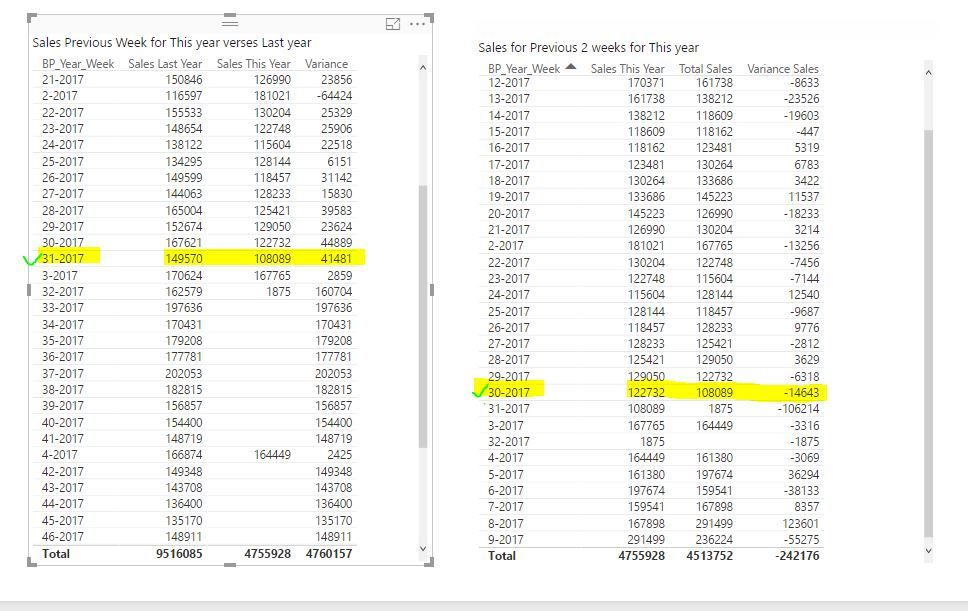

Now I got both my visuals working -
1. Sales for previous week This Year verses Sales for same week Last Year and variance
2. Sales for previous two weeks and variance
Refer below image, so if I filter on 2017-w31 then I get first visual correct but second wrong,
while if I filter on 2017-w30 then I get second visual correct while first wrong.
As we are currently in 2017-w31
1. Compare 2017-w30 vs 2016-w30
2. Compare 2017-w30 vs 2017-w29
I tried changing the measure but I am not able to get what should I change so that both visuals can sync up.
I dont want to show complete table, I only want to show the relevant data as above stated.
Below measure used -
Total Sales = sum(SalesTable[Sales])
Sales Last Year = CALCULATE([Total Sales], DATEADD(DATEADD(Calender[Date_dt], -7, Day), -1, YEAR))
Sales This Year = CALCULATE([Total Sales], DATEADD(Calender[Date_dt], -7, Day))
Variance Sales = [Total Sales] - SalesTable[Sales This Year]
Variance = SalesTable[Sales Last Year] - SalesTable[Sales This Year]

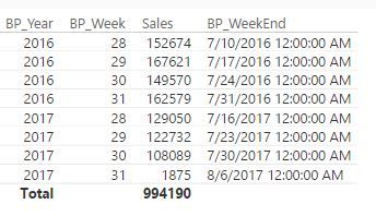

Edit:Below shown are the numbers for sample sales numbers -

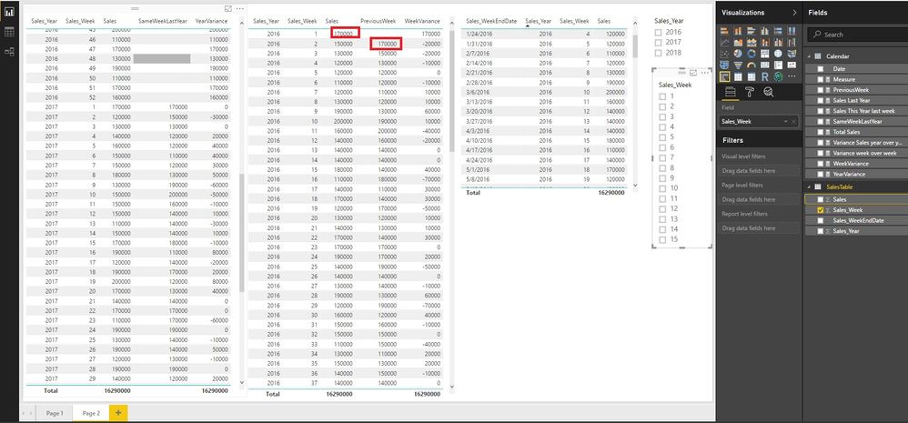

I think we don't need time intelligence functions in your scenario. Maybe you could try this.
SameWeekLastYear = VAR ContextYear = MIN ( 'SalesTable'[Sales_Year] ) VAR ContextWeek = MIN ( 'SalesTable'[Sales_Week] ) RETURN CALCULATE ( SUM ( SalesTable[Sales] ), FILTER ( ALL ( SalesTable ), SalesTable[Sales_Year] = ContextYear - 1 && SalesTable[Sales_Week] = ContextWeek ) )
YearVariance = SUM ( SalesTable[Sales] ) - [SameWeekLastYear]
PreviousWeek = VAR ContextDate = MIN ( SalesTable[Sales_WeekEndDate] ) RETURN CALCULATE ( SUM ( SalesTable[Sales] ), FILTER ( ALL ( SalesTable ), 'SalesTable'[Sales_WeekEndDate] = ContextDate - 7 ) )
WeekVariance = SUM ( 'SalesTable'[Sales] ) - [PreviousWeek]
Best Regards!
