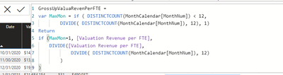

Hello @jl20
Gross Up Valuation Revenue Per FTE
The updated file is also attached for your reference.
https://drive.google.com/file/d/1qdWCfz4FYLN5rlUGwusIqpUi8bJk_OgA/view?usp=sharing
Hope this helps.
Regards
Kumail Raza

Hello @jl20
Hope this helps.
Regards
Kumail Raza
Kumail,
Awesome solution! This works perfectly. Thanks!
