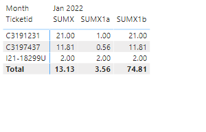

I have simplified my presentation of the problem and made an advancement.  Hopefully this increases the odds of someone being able to show me the error in my approach.
First,,,,, Here is a display of my problem..
All values except for the totals for SUMX and SUMX1b  are correct.
Column SUMX shows the results using my original scrript above.  Which is comprised of a Daily Rate x WorkDays
Column SUMX1a shows the results of a script dispalying just the Daily Rate.  This works as required.
Column SUMX1b shows the results of a script displaying the Daily Rate x WorkDays.  The error with this calculation implies the issue is with the WorkDays calculation.

Pat.   First... I am sorry I did not try this earlier.  I believce I missed it.
It seems to work  🙂
 Not yet sure why it work yet.  Hopefully the video will fill in the gaps.
Not sure I would have gotten this on my own,.
I can email you a copy of the PBIX file if it woulf be helpful
I changed the existing SUMX measure to:  return  SUMX(VALUES(TicketDataTable[Ticketid]), BusDays * PoolHrsPerCasePerBusDay)
There was no change to the Matrix visual.  Incorrect totals and missing values persist.
