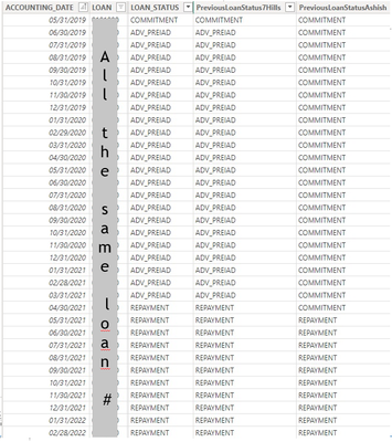

Thanks so much, @Ashish_Mathur, I'm definitely getting warmer.  Your formula worked in the way that SevenHills' didn't, but there are still some loan numbers that yours didn't work for: the ones where there were three loan statuses- it just took the first and the third.
Here is one where yours WORKED and theirs didn't:
Your DAX
And here is one where theirs captured all three statuses, but don't capture the previous line like yours did:
What I was using for theirs (I had to modify it a bit to get the above):
Somehow the best of both formulas need to be combined.
I truly appreciate your time and effort, I am not good with CALCULATE, especially ALLSELECTED!

Thanks, @Ashish_Mathur.  I'm sending one that works and two that don't work.  I'm still trying to understand why the sample data gave no errors.  Could it be that the other columns in the table provide additional context?

Here is the DAX you provided:
PreviousLoanStatusAshish =
COALESCE(
    CALCULATE(
        MAX(
            LOANHISTSorted[LOAN_STATUS]),
            FILTER(LOANHISTSorted,LOANHISTSorted[LOAN] = EARLIER(LOANHISTSorted[LOAN])
            LOANHISTSorted[ACCOUNTING_DATE] < EARLIER(LOANHISTSorted[ACCOUNTING_DATE]))),
______________________________________
Here is SevenHills' Dax:
PreviousLoanStatus7Hills =
var _cal =
CALCULATE(
    MAX(
        LOANHISTSorted[ACCOUNTING_DATE] < (LOANHISTSorted[ACCOUNTING_DATE]),
        FILTER(ALLSELECTED(LOANHISTSorted),
        LOANHISTSorted[ACCOUNTING_DATE] = EARLIER(LOANHISTSorted[ACCOUNTING_DATE])))
    COALESCE(_cal, LOANHISTSorted[LOAN_STATUS])
_________________________________________
I feel like it should be a combination of the two somehow?
Or could it be that the DAX is putting the Loan_Statuses in alphabetical order or something?  Here is a list of possible Statuses:
