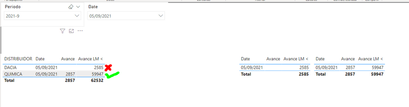

Hello community, I always guide myself from their publications but it is the first time I look for and look for and I do not find if they can help me with this problem that has come out:
As the title says I want to filter in some way the sales of the previous month that I get with this formula:
Advance LM < =
CALCULATE([Advance],DATEADD(Calendar[Date],-1, MONTH))
And only show sales from the previous month when they have sales in the current period. Some told me but condition if it is blank then do not put anything, if that can work when it is separated by category. But when they are grouped, the conditional does not work:
I am using as an example only one day I leave you a test pbix that I put together to try to perform the measurement.
PBix :
https://we.tl/t-UzhXXDMTBG
@Greg_Deckler
Write this measure
Measure = SUMX(FILTER(VALUES('data pruebas'[DISTRIBUIDOR]),[Avance]>0),[Avance LM <])

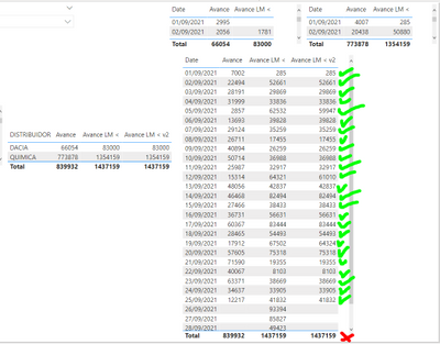

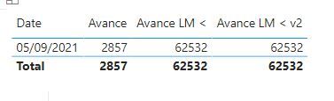

As I tell you it is true that it serves when it is blank, but when they are grouped it no longer respects the condition the correct result should only be: 59947
Write this measure

Hello I worked well at the level records this formula but to show every day is not adding correctly the value, I was thinking of using a hasonevalue but it would not be the solution since this measure will be used in many ways and you would have to create many hasonvalue :
@Epuma
Which measure are you using for this screenshot? Have you tried my suggestion using the SUMX(Calendario ... this will provide the context for the totals row you're looking for.
