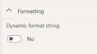

Hello! You can create the format string to display as a percent. In Power BI, click on the calculation item that you want to format, then expand Formatting and toggle dynamic format string to on
Once it is on, you can enter the formatting you want:
For percent you can do "#.#%" or however many decimal places you want.
