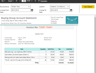

Hi, @Anonymous
According to your description, you said you have 10080 rows of data and you want to make them displayed on one single page, I think paginated reports in Power BI can perfectly meet your requirement, you can follow these documents:
https://docs.microsoft.com/en-us/power-bi/paginated-reports/paginated-reports-faq
If you still have a problem, you can reply to me.

Hi @v-robertq-msft ,
Thanks for your reply. I don't want paginated reports as tables. I need a line chart with date and time in X axis and temperature readings in Y axis. Here is the data. The temperature is recorded for every minute for 7 days.
