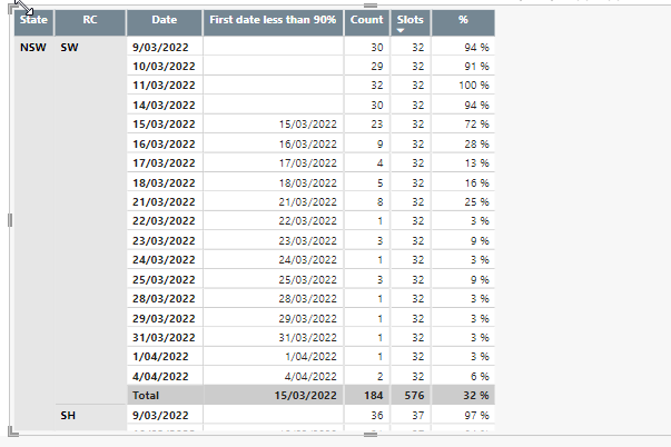

First Date where the % is less than 90
I have below report, I want to show the first date where the % is less than 90% per State per RC.

This is my DAX:
First date less than 90% =
VAR newtable =
ADDCOLUMNS (
SUMMARIZE ( Count, Location[State], Location[RC], Data[Date] ),
"@ratio", CALCULATE ( DIVIDE ( SUM ( Count[Count] ), SUM ( Slots[Slots] ) ) )
VAR filtertable =
FILTER ( newtable, [@ratio] < 0.9 )
IF ( HASONEVALUE ( Location[State] ), MINX ( filtertable, Data[Date] ) )
and I get below, it correctly filter <90, but not the min date per RC:

I can't share the pbix because I have tabular model.
This is my DAX:
VAR newtable =
ADDCOLUMNS (
VAR filtertable =
