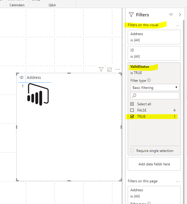

Hi @Revokez ,
We can add a custom in power query editor to identify if this url is valid:
ContentType = Binary.InferContentType(Web.Contents([Address]))[Content.Type],
t = Table.RemoveRowsWithErrors(#table({"Type"} ,{{if Text.Contains(ContentType,"image") then 1 else null}} )),
RemoveNull = Table.SelectRows(t,each not List.IsEmpty(List.RemoveMatchingItems(Record.FieldValues(_), {"", null})))
not Table.IsEmpty(RemoveNull)
Then you can use it in any filter you want.
If you are using the local file address, try to use the File.Content instead of Web.Content
Best regards,

Hi @Revokez ,
Best regards,
Thank you for providing a solution for this issue. I have successfully added the column, but all of my URLs evaluate as false. Whether the image exists or not.
