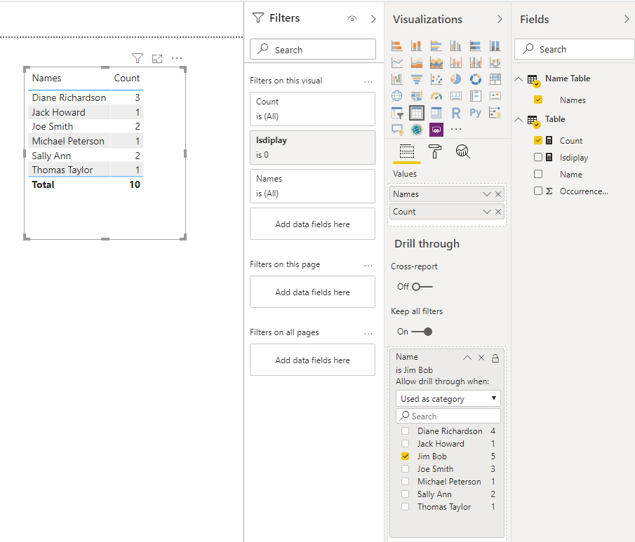

Filtered table to filter another table
I am looking to filter a table based on the filtered results from a drill through. On the main page I have a table of names, I would like to drillthrough and go to their "Associates" on another page. On the Associates page i would have a list of the Occurrence numbers related to the person I drilled through on. I would like to use that list to filter a duplicate copy of the main table (so the drillthrough does not apply), and return all the names of people that are not the Name i used to drill through.
Here a sample dataset
OccurrenceNoName
12345Jim Bob
12345Diane Richardson
12345Sally Ann
12345Joe Smith
12346Jim Bob
12346Joe Smith
12346Jack Howard
12346Diane Richardson
12346Thomas Taylor
12347Jim Bob
12347Michael Peterson
12348Jim Bob
12348Sally Ann
12349Jim Bob
12349Diane Richardson
12350Diane Richardson
12350Joe Smith
If I drill through on Jim Bob, these are his occurrences, I need to use to get the names of his associates
These are the results I want

  • v-alq-msft's avatar
    v-alq-msft
    Hi, BDolphin
    Based on your description, I created data to reproduce your scenario.
    Table:
    Name Table:
    You may create two measures as follows.
    Isdiplay =
    IF(
        SELECTEDVALUE('Table'[Name]) = MAX('Name Table'[Names]),
        1,0
    Count =
    SUMX(
        'Name Table',
        CALCULATE(
            COUNTROWS(
                FILTER(
                    ALL('Table'),
                    'Table'[Name] = MAX('Name Table'[Names])
    Then you can put 'Isdisplay' to the visual level filter and set the field for drill through as 'Name'.
    Finally when you drill through from the Page1, you will get the expected result.
    Allan
        v-alq-msft
        Hello, @BDolphin
        You can modify the "Count" measure as follows.
        Count =
        SUMX(
            'Name Table',
            CALCULATE(
                COUNTROWS(
                    FILTER(
                        ALL('Table'),
                        &&  'Table'[OccurrenceNo] in DISTINCT('Table'[OccurrenceNo])
        result:
