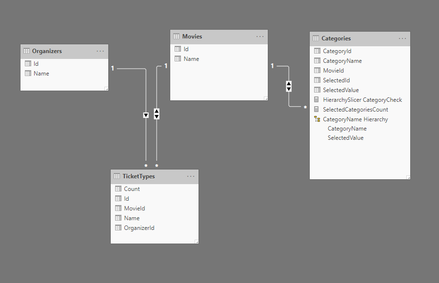

I have these relationships:

I thought that the relationship would be enough to filter the TicketTypes according to the filtered Movies table but everything I have tried to manipulate this behaviour hasn't worked. Are there any experts out there that can see what's wrong or missing?

1. change the cross filter direction from "Single" to "Both" Between "Movies"table and "TicketTypes" table
2.apply the [HierarchySlicer CategoryCheck] on the "TicketTypes" tables visual too.
