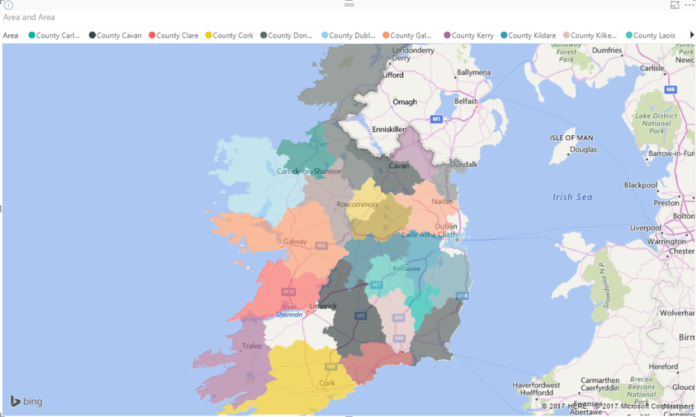

Unfortunately when using the Filled Maps visualization i often find counties in Ireland not showing, or partially showing (i assume similar might be seen for American states?). The data i am using toindicate the counties is not changing but the information on the displayed map changes regularly when i open power bi which i dont understand. In the image below some sections of Dublin are missing and all of county Limerick
any ideas?

I am having the same issue, with the counties Clare, Roscommon and Wexford.
Clearly this issue is caused by the fact that there are existing counties in Michigan, USA with the same names. There needs to be a way to set the country to Ireland

please see link below to the excel file, the .pbix is simply just a file with a filled map in it. Note that when i tried to open the file this morning it worked fine without issue, its very odd that somethings the issue is present and other times its fine.
when i initially built the excel file and added to a filled map i have the same problem, but it was Clare and Limerick that werent showing up. then i added 'County' in front of each field and it worked, but thinking back i dont think putting 'County' in front of them actually solved the problem, its more an intermittent issue. So far have seen Limerick, Clare and Sligo not being populated, and when Dublin is not highlighted it is never all of dublin, its only partially missing, i.e. the middle bit is there but top and bottom sections are blank.

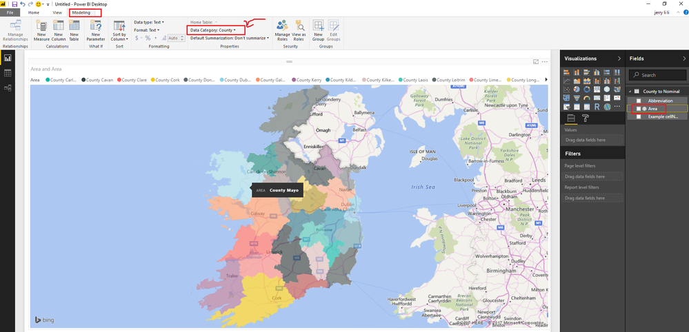

Hi @Anonymous,
It works all fine for me after I set Data Category to County for Area column under Modeling tab with the latest version of Power BI Desktop(2.49.4831.521 64-bit (August 2017)). Could you go to check if setting Data Category to County works for you?
Regards
hi,
ok so when i build the filled map from the file it works fine (as menitoned previously the issue was intermittent). by default the Data Category is set to Uncategorised, and when i open dashboard earlier it worked fine, all counties were highlighted without issue.
However when i select County as the Data Category PBi sees a number of counties now being defined over in the USA and Canada, when you zoom into Ireland you will notice that Dublin, Wexford, Clare and Roscommon are now fully blank.
When you change the Data Category to Place you lose all of Limerick and only central Dublin remains highlighted.
The only options for Data Category that are working for me today, i.e. are showing all the counties highlighted, are:
Uncategorised
Latitude
Longitude
State or Province
This obviously isnt an easy fix, maybe on the days the Uncategorised option doesnt work ill just try change the Category field and hope it helps
Dave
