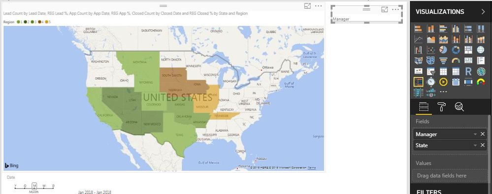

Hi there, and thank you very much for your reply.
Your solution work, but my problem is for instance in the map I have to split California in two and others states also. that is why I have to use a custom map.
I found the solution in the follwoing post using the synoptic panel and the synoptic designer.
thanks again.
Regards
Synoptic panel:
https://okviz.com/blog/introducing-synoptic-panel-v1-4/
Synoptic Designer:
I know I'm a little late to this thread, but I was able to use Filled Maps to subdivide a state. I created a column that had county level data (how I needed to divide my states) for only the states I needed to split up and just state level for other states. I then gave that column a data category of place. PBI mapped everything perfectly. Hope that helps with your problem next time it comes along!
- sajarac6 years ago
Helper III
Never is too late, Thank you very much!!
