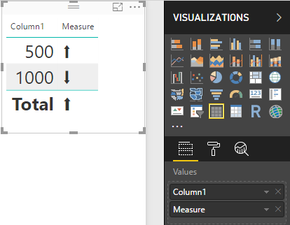

Hi @tarun16feb,
It seems no green arrow in unichar. Maybe you can try to format the column. Please refer to Power-BI-Desktop-DAX-Using-Unicode-Arrows-as-Measures-in-a-Tabl.
Measure = IF ( MIN ( 'Table1'[Column1] ) < 600, UNICHAR ( 9650 ), UNICHAR ( 128315 ) )

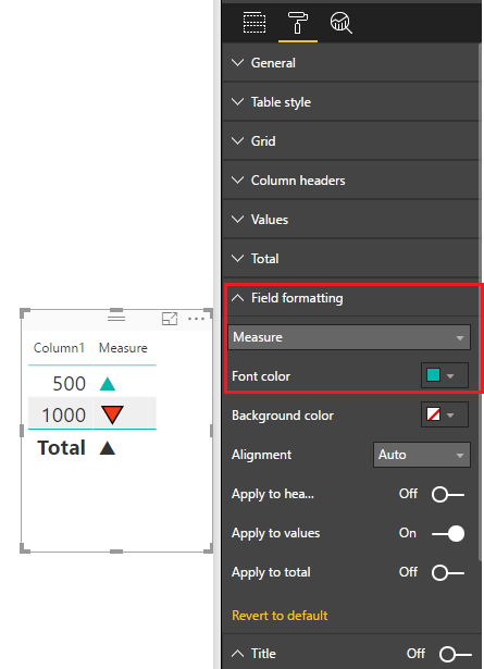

Hi @tarun16feb,
Maybe you can use unichar instead. You can try it like this. You can find out more arrows here.
Measure = IF ( MIN ( 'Table2'[Column1] ) < 600, UNICHAR ( 11014 ), UNICHAR ( 11015 ) )
Dale
Hi
Thanks for getting back.
I am looking for an upward triangle with green color and downward triangle with red color.
I couldn't find the colored ones. Can you please point me in the right direction.
Hi @tarun16feb,
Dale
