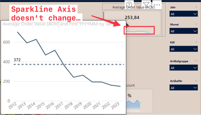

    There is only 1 thing I am struggling with:
    I need this dynamic value also in my sparkline visual.
    Is this also possible ? I tried to replace the Monat column with the Field Parameter, but I couldn't make it work...
    I thought that I just need a DAX Measure exactly the same as the Top1 visual filter, but I couldn't extract the Field Parameter inside a measure ?!
    Do you have any idea ? This is the link where I copied the Sparkline DAX Code: Link
    Thank you anyways very much in advance!!! 😊

      Hi ahanfouf
      I don't think it is possible with sparkline,
      as an alternative combine cards with the regular line chart .
      I have these combinations in my dashboards and it looks great.
