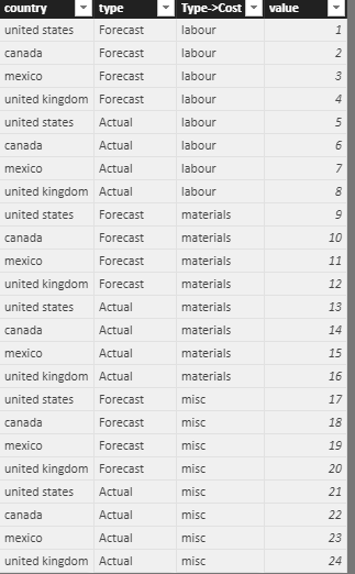

Hi, my client requested to create a chart that combine stacked and column chart together.
From my research, most of the solution only say "You can't"

I mean, Are there any workaround to get into that chart, i.,e. manipulating the data so the axis can be adjusted (there are tips in excel to manipulating the axis, but i am not sure how to do it in powerBI) ?

Hi @andrehawari
Currently, It is not possible to create a Combination of Stacked and Column Chart, you can vote for this idea.
A workaround described in the fiist link would like below

Hi @andrehawari
You can do that in another way, create a hierarchy of Country=>Type and use that value in the x-axis, and use `Type->Cost` as the legend.
I think this would help you to get what you are looking for.
The below Image will give you more clarity.
