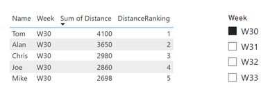

I'm working on a visual report to display the three best values on a podium with 3 cards, using slicer and visual table.
Data are stored on the following table :
I want to visualize the three best persons with the maximum distance for a selected week.
At the first time, I computed a table :
DistanceRankingTable = SUMMARIZE(CALCULATETABLE('Demo','Demo'[Week]="W30"),'Demo'[Name,'Demo'[Week],"Distance",SUM('Demo'[Distance (odometre)]))
All seemed to work well ... but that was not possible to interact with UI filter (slicer) to select a week and replace "W30" by a variable binded to an UI object.
So, I tried a new method, to interact with visual table / results.
I added a slicer to select the week and filter the data of the "Demo" table.
A new measure "DistanceRanking" was added to determine the 3 best persons, using the code :
DistanceRanking =
    RANKX(
        ALL('Demo'[Name]),
        CALCULATE(SUM('Demo'[Distance]))
The format is "whole number".

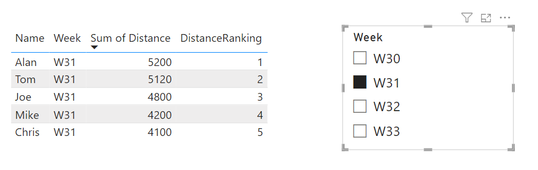

The rankings are correct for all weeks :
But, the issue is coming.
The "card" displays the Name as wanted but the filter "DistanceRanking" is not enabled to set the ranking value to "1" for the first (or "2" for the second, "3" for the third).
When a new week is selected, all data are refreshed, rankings are well calculated, but the card displays all the time the first alphabetic item, because no filter for the ranking can be defined (dropdown is not enabled).
How can I set the ranking to 1 (2 and 3) to retrieve the 3 best players ?

  • cln measures can be only used as a visual level filter, not a page or report level filter.
