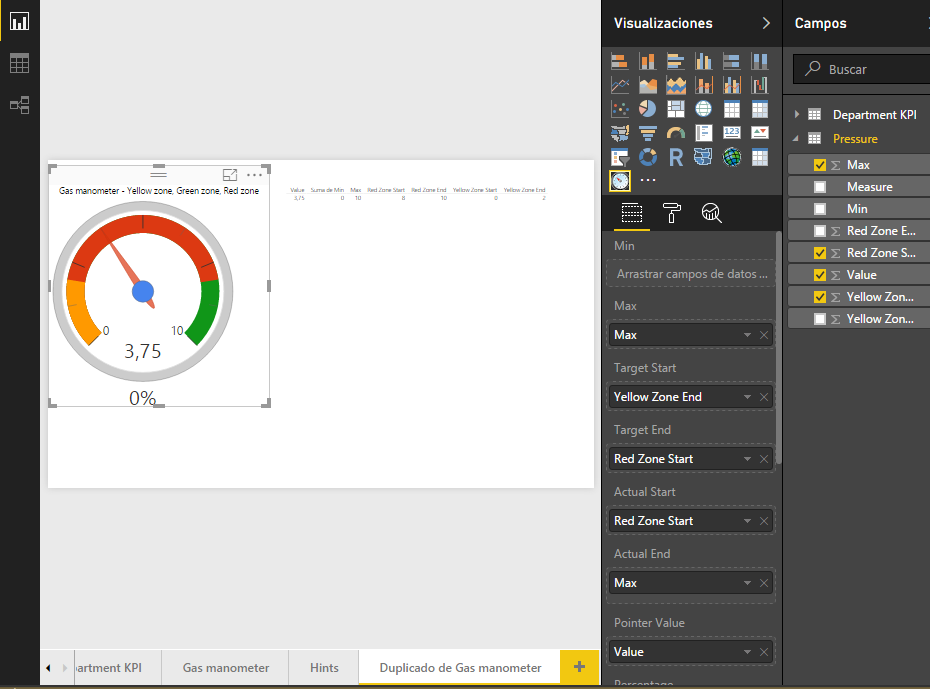

        Hi radhikadebi,
        I have your problema, but I don´t know to solve it.
        I use the example of Pressure form de Visual Component Example.
        I want yo have:
        0-2 GREEN
        2-8 YELLOW
        8-10 RED
        Can you help me?
        Thank you
        Regards from Spain
        Antonio
