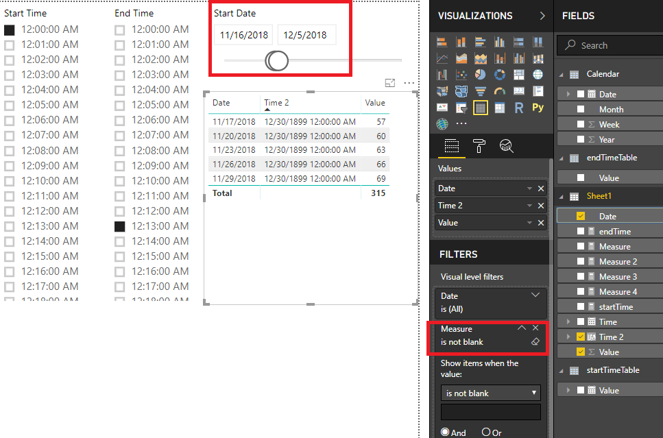

Hi @jinma78,
Two tables for Hour and two tables for Minute. I would suggest creating two time table instead. Please refer to the snapshot below.
startTimeTable = GENERATESERIES ( TIME ( 0, 0, 0 ), TIME ( 23, 59, 0 ), TIME ( 0, 1, 0 ) )

Hi @ni30,
1. The [Time] isn't a pure time in your demo. Please refer to the snapshot below. It should be [Time 2].
2. Since the Date and Time are two columns, I would suggest you make some changes like below. Remove one table and delete several relationships.
3. Create a measure.
Measure = VAR startTime = MIN ( startTimeTable[Value] ) VAR endTime = MAX ( endTimeTable[Value] ) RETURN IF ( MIN ( 'Sheet1'[Time 2] ) >= startTime && MIN ( Sheet1[Time 2] ) <= endTime, 1, BLANK () )
4. Add the measure in the Visual Level Filter and set it as "is not blank".
Please also download the demo from the attachment.
