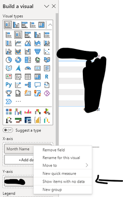

    Turn on this

      Thank you for the swift reply.
      It partly works but it will empty article numbers also. I think the issue comes because article numbers come from sales header and shipments are connected to sales lines.
