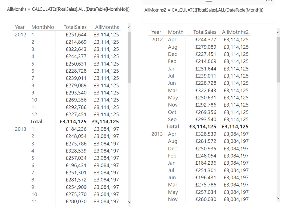

I have a problem with a DAX expression. It’s when I want to use the ALL function on the Month column of my Date Table to show Total Sales across all months in each year. If you look at the table on the right, you can see the expression for the “AllMonths2” measure which is calculating correctly. You can also see that the expression also works if I use the MonthNo column instead (in the “AllMonths” measure in the table on the left)

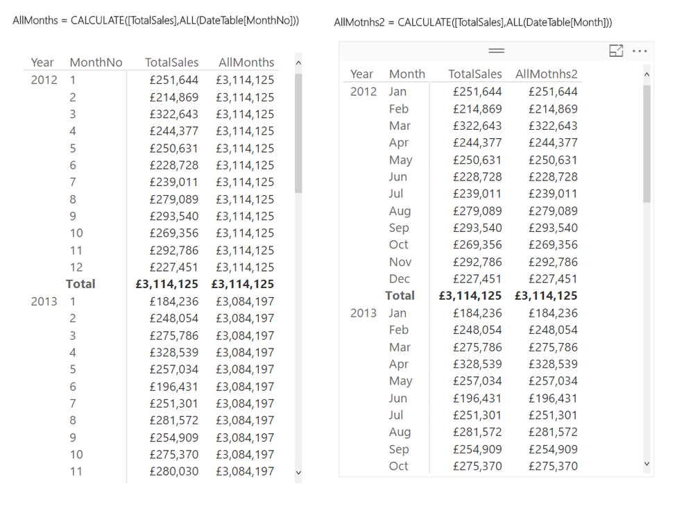

However, if I sort the Month column by the MonthNo column, I now get an incorrect result from the expression: -
Am I doing something wrong?
@Burningsuit,
What you describe is by design. When Month column is sorted by MonthNo column, adding Month column to a report also add MonthNo column to the report. Thus, the measure must apply ALL to both Month column and MonthNo column, in other words, you should create the measure using the DAX as below.
AllMonths2= CALCULATE([TotalSales],ALL(DateTable[Month]), ALL(DateTable[MonthNo]))
There is a issue for your reference:
https://community.powerbi.com/t5/Issues/Bug-with-Power-BI-Desktop-ALL-function/idi-p/181454
@Burningsuit,

Check out my blog: Power BI em PortuguêsThe Month column comes from a DateTable, no calculations are involved.
The date table looks (something) like this.
Date Month Monthno
30/06/2017 June 6
01/07/2017 July 7
02/07/2017 July 7
and so on.
The Transactions table looks (something) like this
Date Sales
01/07/2017 123.12
01/07/2017 234.34
and so on.
Obviously the two are related via Date in the DataModel
TotalSales is a SUMX of Sales. However I've tried this with different DAX aggregations and the same problem exists.

Check out my blog: Power BI em PortuguêsNo, The calculation WORKS FINE, when the DateTable column "Month" is not sorted by "MonthNo", but of course the months are listed in alphabetical order. However when the "Month" column in the DateTable is sorted by "MonthNo" - in order to list the Months is the correct order, the calculation does NOT work. Why should this be ?

Check out my blog: Power BI em PortuguêsNo, @MFelix you misunderstand. The expression is ALL(DateTable[Month]) which simply removes the filter from the month column to show the values for the entire year of the current filter context (e.g 2017). The data type does not affect the expression. I think we have a bug in DAX here. Look at the examples in my original post, it works when the column is not sorted by monthno. Using the sort by column option on the modeling tab produces the problem.
