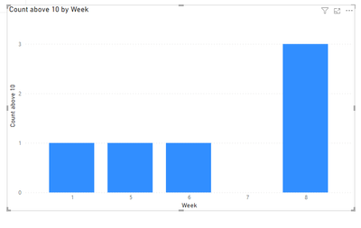

Below is a sample of my data. I would want to create a DAX measure that counts the number of companies (distinct!) that have >= 10 Items sold per week. I would then want to show the DAX measure in a bar chart with the week number in the x-axis.
Highlighted in green are the values (summed up per Week) that I would want to count.
Desired output:

Hi @Mr_Glister ,
I made simple samples and you can check the results below:
Total Count = var _t = ADDCOLUMNS('Table',"total",SUMX(FILTER(ALL('Table'),[Week]=EARLIER([Week])&&[Company]=EARLIER([Company])),[Item sold]))
RETURN CALCULATE(DISTINCTCOUNT([Company]),FILTER(_t,[Total]>=10))
An attachment for your reference. Hope it helps!

Daniel29195
@Mr_Glister
item sold = SUM(table23[ Item sold]
Count above 10 =
var datasource =
FILTER(
ADDCOLUMNS(
        values(Table23[Company]),
        "sold" , [item sold]
[sold] >=10
return
COUNTROWS(datasource)
let me know if you have any problem implementing it .
