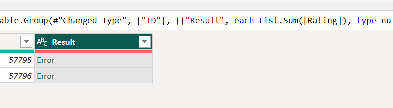

Use group by as in below Screenshot,
There will be a error,
To solve this us below Expression
= Table.Group(#"Changed Type", {"ID"}, {{"Result", each Text.Combine([Rating],","), type nullable
