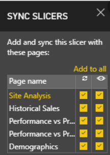

Because -> You can determine where the slicers are synced and displayed. (see first and second column of my screenshot below). (Sync Slicer Funcitonality)
Can it be that you have to update your bookmarks because it can happen that there are strange behaviors due to not updated bookmarks?
So what would I do now.
  1. Delete all slicers (except the ones from the first page) that would be synced/shown from the first page
  2. Sync/Show the first page slicer on all pages where I want them
  3. Update all bookmarks since they can store info that is no longer valid
  4. Finished

I have to admit that I don't understand exactly what your problem is.
  4. Finished
If this post was helpful may I ask you to mark it as solution and give it some kudos?
Have a nice day!
BR,
Josef
