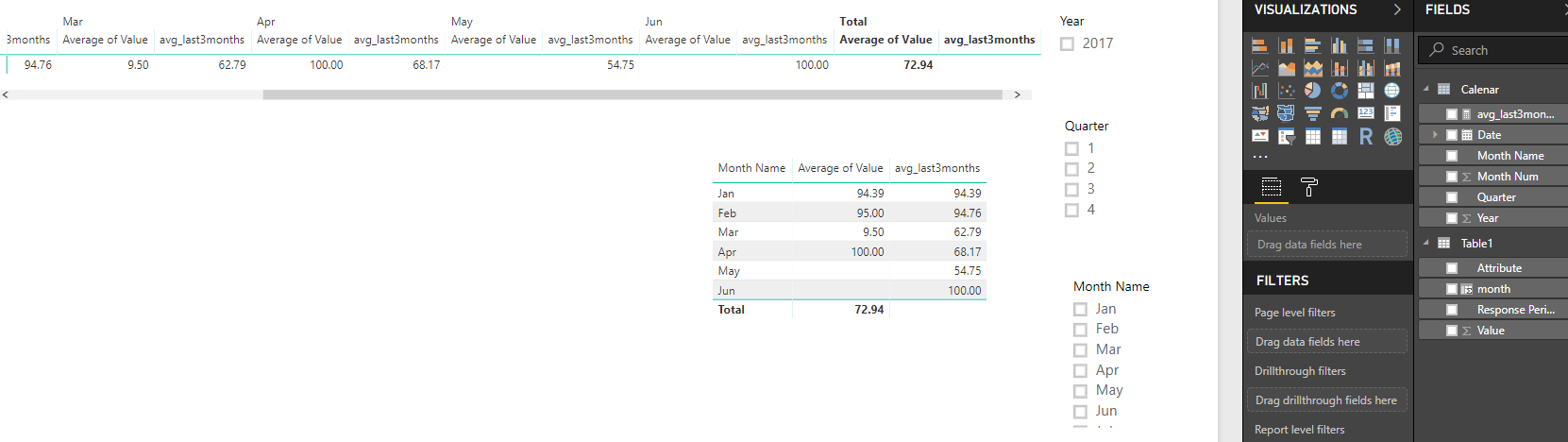

Hi Nishanth.,

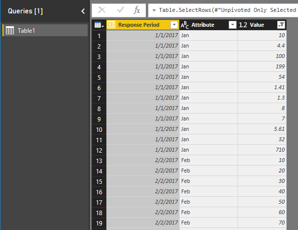

I guess your data looks like this:
So, the last four columns are necessary. This mode needs a date table that will provide all date attributes. We need to unpivot these data to make it easy to handle. Please check out the demo here.
Create a measure like this:
avg_last3months =
AVERAGE ( Table1[Value] ),
DATESINPERIOD ( 'Calenar'[Date], MAX ( 'Calenar'[Date] ), -3, MONTH ),
ALL ( Table1[Attribute] )
)Best Regards,
Dale
