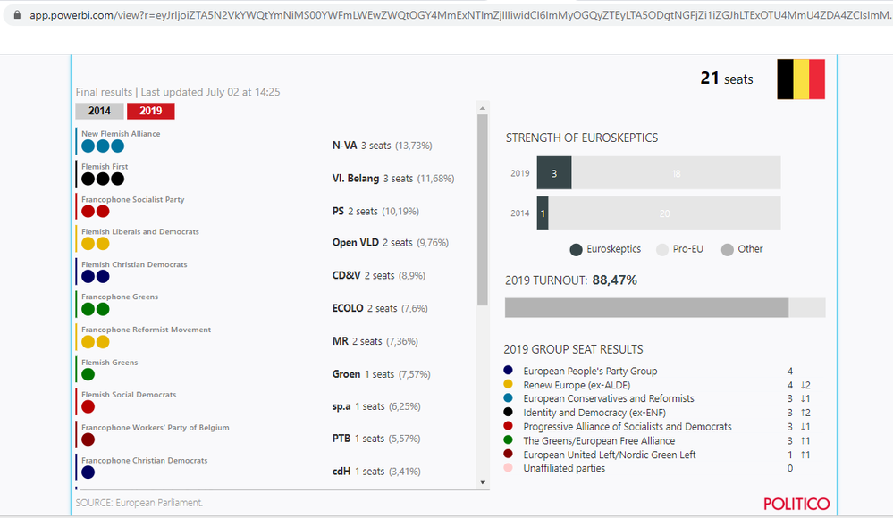

In the above exemple the link does exactly what I need, but I don't understad how, and the user that published it dosen't understand either, but havin the end of the url with
&Country=Belgium
https://app.powerbi.com/view?r=eyJrIjoiZTA5N2VkYWQtYmNiMS00YWFmLWEwZWQtOGY4MmExNTlmZjllIiwidCI6ImMyO...
and the same url with
&Country=Austria
Gives diferent results, and this is what I am trying to do, any suggestions to how does this work?
this is a report thats published to web viewing the Link
thanks in advance for any help

Hi @amitchandak ,
Yes it is an embedded report
