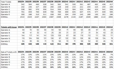

Hi I'm working on a report to measure the ratio of tickets with issue over total tickets processed. These 2 values are coming from 2 different data sources. I was able to create a weekly summary of the tickets with issue and a summary for the total tickets processed. How do I create a summary table showing the ratio of total tickets issued over the total tickets processed? Appreciate

Here's the data I generated in excel.
Total Tickets is from one data source and Tickets with issue is from another data source. The bottom table is the ratio of the 2 tables. How can I do this in Power BI?
Thank you for your inputs.

Vlapena , Add both of them as tables, Unpivot to get a week on rows. Create common dimesions
Power Query- Pivot, Unpivot Data: https://www.youtube.com/watch?v=FUaGQBG5YnI&list=PLPaNVDMhUXGbfdGuSsfPR1qKBRT5Ywlki&index=3
