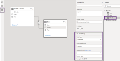

@APM You can create an additional table off your date table to have both years and the ranges.  I've included a PBIX file with this set up.
The Date table I used:
Date =
ADDCOLUMNS(
CALENDAR(date(2019,1,1),date(2022,12,31)),
"Month", date(year([Date]),month([Date]),1)
then the additional table, Switch Calendar:
Switch Calendar =
var startmonth = 4
return
union(
ADDCOLUMNS(
SUMMARIZE('Date','Date'[Date]),
"Year", if(month([Date])>=startmonth,date(year([Date]),1,1),date(year([Date])-1,1,1)),
"Calendar", "Fiscal"
ADDCOLUMNS(
"Year", date(year([Date]),1,1),
"Calendar", "Calendar"
then I set it up with a bi-directional filter on the [Date] column in each table.
Edit: I changed it to reference the Date table instead, so if you wanted to change the range, you only have to in one place!
Edit 2: Re-reading your post, your fiscal calendar starts in April, so just changed the start month to 4.
Final note, in the Date table I havethe Month as a date, which I then formated custom to be in the mmm yyyy format on the modeling tab. This also allows for you to use it as either continuous or categorical in the x-axis on charts.
Respectfully,
Zoe Douglas (DataZoe)
Follow me on LinkedIn at https://www.linkedin.com/in/zoedouglas-data
See my reports and blog at https://www.datazoepowerbi.com/

Thanks! And so, when I import my data, I add the relationship so that the data in my Sales dataset is tied to either the date column in the Date table or the date column in the Switch Calendar table, correct? Because it won't let me create a relationship with both.
Or do I need to do something else?
DataZoe
@APM Great question, yes you would want to create the relationship between the Sales data and the Date table only.  The only table Switch Calendar should have a relationship with is the Date table.
