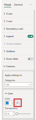

I have this below visual :
Blue color bars are current temperature. I want to show bar in different colors(cool=blue, orange=heat, green=fan) from which Usermode this comes from.
I don't want to drag this user mode column into the legend field as that will show every fields in legend as below:
legend should only display current temperature, Average site temp, set point temp, fan speed.
User mode should be displayed in different colors for current temp bars and even a data label to show as usermode as heat,auto,cool etc.
Please advise!
PFA file here Heatsense - Copy - Copy.pbix

Column Color =
VAR _UserMode = SELECTEDVALUE('HeatSense_Device'[UserMode])
SWITCH(
TRUE(),
_UserMode = "cool", "#12239E",
_UserMode = "heat", "#FF8C00",
_UserMode = "fan", "green",
"#808080"
Please advise!
Thanks in advance!

First, create a measure for color-coding based on Usermode:
daxCopyColorByUsermode =
SWITCH(
VALUES(Table[Usermode]),
"cool", "#0066CC", // Blue
"heat", "#FF6600", // Orange
"fan", "#33CC33", // Green
"#0066CC" // Default blue
Create a measure for the legend labels:
daxCopyLegendLabel =
VAR CurrentMode = VALUES(Table[Usermode])
SWITCH(
TRUE(),
SELECTEDVALUE(Table[Measure]) = "Current Temperature",
"Current Temp (" & CurrentMode & ")",
SELECTEDVALUE(Table[Measure]) = "Average Site Temperature",
"Avg Site Temp",
SELECTEDVALUE(Table[Measure]) = "Set Point Temperature",
"Set Point Temp",
SELECTEDVALUE(Table[Measure]) = "Fan Speed",
"Fan Speed",
"Other"
Then to implement this:
Remove the Usermode from the legend field
In the format pane:
Use the ColorByUsermode measure for the bar colors
Use the LegendLabel measure for the legend text
Add a data label to show the Usermode text on the bars

Write this DAX which sets the color for the columns
Column Color =
SWITCH(
TRUE(),
_UserMode = "cool", "blue",
_UserMode = "heat", "orange",
"grey"
Then apply that as a Conditional Formatting rule
Note that the grey columns don't have an associated UserMode, hence they are grey.

Hi Phil,
Thanks for your quick response!
Your dax is perfect and works when deviceid is on X-axis.
But when I dragged UpdatedOn date column from Heatsense Device table into x-axis different colors doesn't work:
Also, is it possible to label them as cool, heat, fan on their respective colors?
Please advise!
PFA updated file here Heatsense - Copy - Copy.pbix
Thanks in advance!
