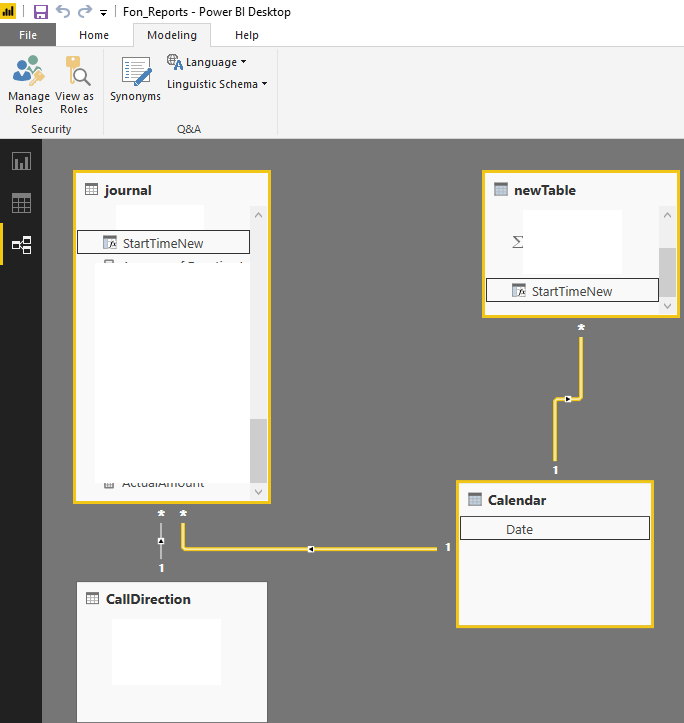

1. Your dates have time part. Since you don't analysis time here, we add a new column to tables [journal] and [newTable].
StartTimeNew = newTable[StartTime].[Date]
2. Create a date table.
Calendar = CALENDARAUTO()
3. Establish relationships.

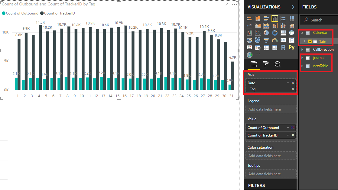

4. Create the Table visual.
Dale

- v-jiascu-msftMicrosoft Employee
Hi Anonymous,
We need to establish relationships to connect these tables. It seems the Axis is [TrackerID]. I would suggest you create a table that is full of [TrackerID] then establish relationships among them. The final result is the Axis is 'New Table'[TrackerID].
Can you share a sample file? The solution could be more clear.
Dale- v-jiascu-msftMicrosoft Employee
Hi Anonymous,
Please refer to the steps below.
Dale
