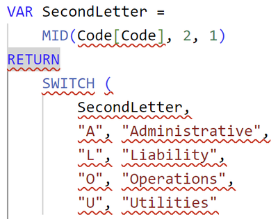

Create a Conditional Measure working with a Direct Query Semantic Model
I am working with a Semantic Model so I am not able to use the Transform Data option from Power BI.
In the Semantic Model I have a column Code and I want to create a column Code Desccription. This new column is based in the second letter of the Code: For instance, if Code is CAB, second letter is A then Code Description will be Administrative. I want to use this Code Description in a Filter to create visualization with this Code Description column. Please your help!

  • Hi YesP
    Try this:
    VAR SecondLetter =
        MID ( TableName[ColumnName], 2, 1 )
        SWITCH (
            SecondLetter,
            "A", "Administrative",
            "L", "Liability",
            "O", "Operations",
            "U", "Utilities"

        It appears you are creating a measure and not a calculated column. You cannot directly access a column in a measure (unless in a table expression or when filtering) without aggregating it beforehand. Use this:
         MID ( SELECTEDVALUE ( TableName[ColumnName] ), 2, 1 )

        Create a calculated column instead. Measures don't have row context and are evaluated based on the other dimensions added to a viz so it cannot be used as a dimension or in a slicer. The first formula without SELECTEDVALUE creates a calculated column.

    Thanks for the reply from danextian , please allow me to add some more information:
    Hi  YesP ,
    1. In Power Query – Add Column – Custom Column.
    if Text.Start([Code], 1)="C" and Text.Length([Code])=3
    then 1 else 0
    if [Custom]=1 and Text.Middle([Code], 1, 1)="A" then "Administrative"
    else
    if [Custom]=1 and Text.Middle([Code], 1, 1)="L" then "Liability"
    else
    if [Custom]=1 and Text.Middle([Code], 1, 1)="O" then "Operations"
    else
    if [Custom]=1 and Text.Middle([Code], 1, 1)="U" then "Utilities"
    else null
    2. Result:
