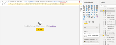

    Hi amitchandak
    Thank you for your reply. I try your solution and it gave me this error
    I think its coming from the Data[Date] As i have date as column in my data table. I really new to power BI so I am not quite sure if I doing it right.
    Do you have further advice?
    Thanks in advance.
    Handy Pratama
