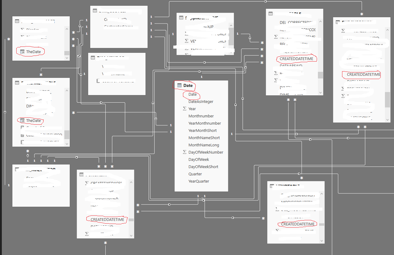

Hello @v-piga-msft , here is a screenshot. I had to omit the table names and other columns because of confidentiality.
Table Relations
The circled columns are the ones connected to the Date table in the middle. The Date table holds all dates from year 2000 till 2030.
If you need more info let me know.
Hey,
I'm wondering if the datetime values match. Creating a calendar table using the CALENDAR function creates datetime values where the timepart is 12:00AM (midnight). Maybe the timepart of the other datetime columns prevents a proper match. If this might be the case. I would recommend that you change the datatype of the date column in your calendar table to date and that you add a new column to the other tables extracting just the date part from the CREATED.... columns.
A last thing you have to check: what datetime column are you using on the visuals, make sure that you are using the column from the CALENDAR table.
