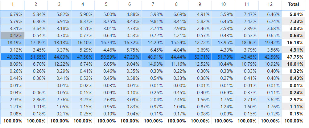

I am new to PowerBI and am in the process of migrating old manual reports to it.

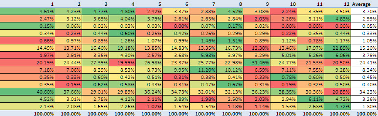

One of these reports shows share of sales, by month (column) by product type (rows).
This has a heat map conditional format that compares any given cell (share of sales for a product for a month) to the total share of sales for that product for the total time period reported on. The under-index (lowest) starts from red, progresses to yellow (the same as the average) all the way up to green for the highest over-index against the average. So in the above, for row 1, April sees the highest index of purchases (4.8%) vs the total average for that product of 3.7%.
I have recreated the pivot-table as a matrix, which was simple enough.
But I can't find any way to match the same conditional formatting logic as my original excel pivot.
Is it even possible?

    • GarethW's avatar
      GarethW
      Hi, thanks, but I have tried that and it doesn't work as there is no way for it to use the last 'total' column as a reference.
      The actual matrix is based on counts, and the display type was just changed to be based on 'Percentage of Column Total'
      What I need to be comparing in the heat map are the percentages being displayed, not the actual counts behind those, as the counts will vary depending on the month, I only care about the relative share for any given month, versus the over all share (which is that final 'Total' column)
