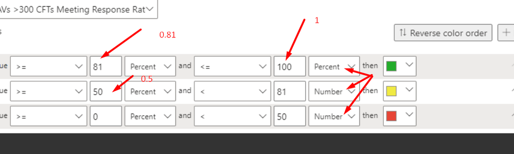

Hello. I'm trying to apply conditional formatting to a measure in Power BI desktop. I want the background color of the field for percents 81-100 to be green, 50 - 80 to be yellow, and 0-49 to be red. This is what the rules look like:

  • you should change the percentage to
    100% = 1
    81% = 0.81
    50% = 0.5
  • Thank you for your feedback Ahmedx
    I've corrected the rules as below:
    That doesn't seem to have resolved the issue. In the first matrix were there is state date which can be expanded to view individual years below each state, I see this when collapsed (viewing state averages):
    The 92 should be green and the 53 should be yellow.
    When I expand the matric to view each year below a given state, I see this (no conditional formatting at all):
    In the matrix where I only have yearly averages, and the same rules as above, I see this (1 cell formatted, the result are not):
