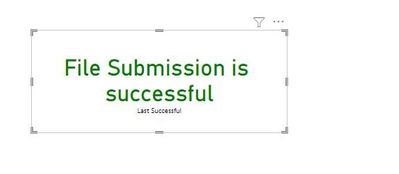

Now I have to create a card based on the last entry, if the last entry says the File Submission is successful =, then it will show something like this.
My only query is how do I colour code the text with green when it says successful and red when not successful.
Hi, @SS_1122
Thank you for your quick response, based on your description you want to show the green and red color according to the return in your card visual. Right?
Here are the steps you can refer to:
(1)This is my test data:
(2)We can create a measure to return the [Successful] of the last date. And we can put the measure on the card visual.
Last Successful = var _date = MAX('Table'[Date])
var _t = FILTER('Table','Table'[Date] =_date)
return
MAXX(_t,[Successful])
(3)We need to create a measure to configure the text color in the card visual.
Color Flag = IF([Last Successful] = "File Submission is successful","green","red")
(4)Then we can configure it in the card visual:
Then we can meet your need , the result is as follows:
