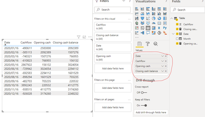

  1. Create a table chart and place columns and measures like this:
And you can get what you want.
You can download my test pbix file here
