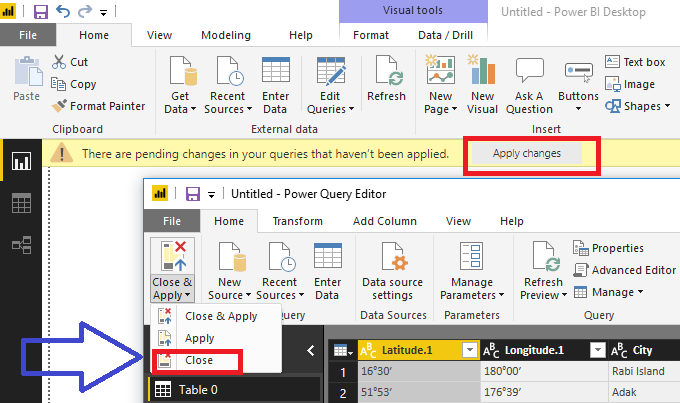

    Hi akj2784,
    The Query Editor is a tool to shape data. The dataset is the source that we will use to analyze. If we don't apply the changes, why should we do that?
    Surely, we can close it without applying the changes.
    Close_and_Apply_Without_processing_in_PBI_Desktop
