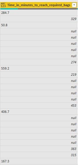

Changing a column from Any data type to decimal
Hi, community. I am new to this community and Power BI Desktop but have built a basic dashboard successfully through the help of some online resources. I am also unfamiliar with DAX. I have imp...
- 4 years ago
I think you need to check regional setting of your machine ..
- 4 years ago
FarhanAhmed, thank you for the advice. I tried getting my regional computer settings sorted, to no avail. However, I found a workaround by using the locale function with the data type. This solved my problem.

Okay, what should it be if not my locale?
