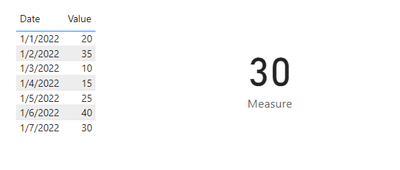

If you want to get the last value instead of the highest value, please try following measure:
Measure = LASTNONBLANK('Table1'[Value],CALCULATE(MAX('Table1'[Date]),'Table1'[Date] = MAX('Table1'[Date])))
I think this is the result you want:

Hi @RamiGamal ,
