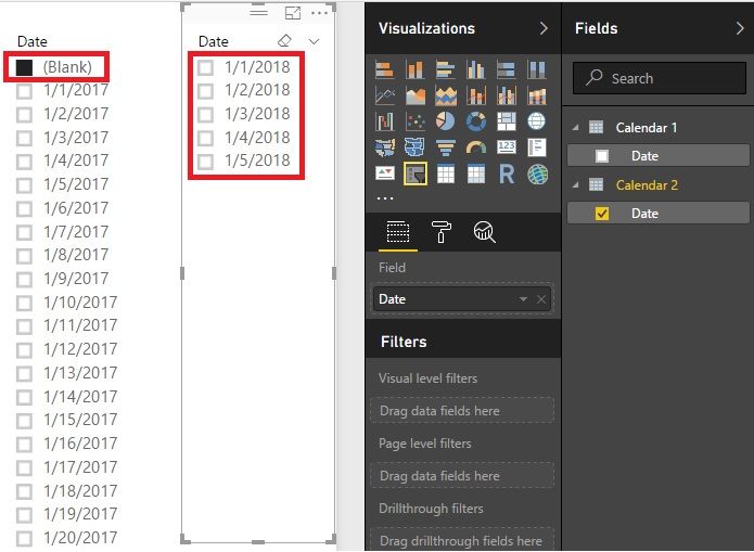

Surely the dates are in the 1 side of the relationship. If the dates in the many side that don't exist in the 1 side will lead a blank option in the slicer. Please check it out.
Here is an example.
Calendar 1 = CALENDAR ( DATE ( 2017, 1, 1 ), DATE ( 2017, 12, 31 ) )
Calendar 2 = CALENDAR ( DATE ( 2017, 1, 1 ), DATE ( 2018, 1, 5 ) )
Best Regards!
Dale
